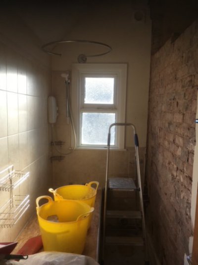

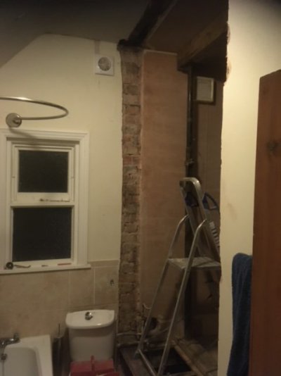

Here's the family bathroom, with the other side of that wall exposed, as I was taking it down. You can see how stupidly narrow it was - the yellow buckets are sat on top of the very narrow bath, the set of steps are where the loo was, which was so tightly pinned in that gap it was uncomfortable to use This picture actually shows the wall when it was part way down - but - first I had to support what was above.
The room above had joists that ended at the wall that I was due to take out. However, rather than bearing on the masonry, they were mortice and tenoned into a wall plate - a timber beam - that ran along the top of that wall. That wall plate was *probably* enough to support the room above without the wall beneath,, but probably is not good enough - so the floor joists above were supported temporarily on one side with acro props and a temporary timber beam, whilst a new timber beam was inserted to cover the to-be-removed wall section. This was subject to Building Control, so I had to get a Structural Engineer to provide the calcs for the beam size and get Building Control in to sign the work off. You see it best in this "after" picture - wall down, temporary support behind the steps, new permanent beam yet to go in:-

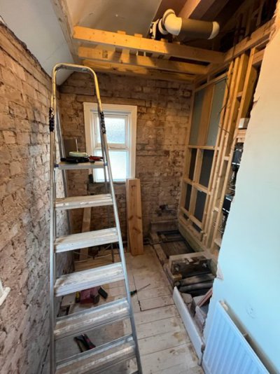

Here's a shot of the en-suite before the new wall went in, but after the plumbing had been prepared:-
There's actually 3 layers of joists, at right angles to each other, under that floor! Handy really, as it gives space to thread pipes through north-south and east-west by changing levels. All supply pipework was done in soldered copper, I don't trust plastic, too many o-rings to fail in future. Waste pipework was done in the big 50mm / 2" size in solvent welded plastic - probably over the top, but it was taking both sink and shower waste and was quite convoluted and would be very difficult to get back to in order to unclog anything - using 2", and making bends as gentle as possible, using slow bends or 2 x 45 degree bends rather than sharp 90 degree elbows, should mean it never clogs.

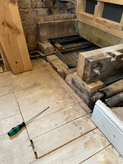

You'll see above there is a joist that's been doubled up. There's a good reason for this, and it's typical of the level of workmanship of the previous en-suite. This joist is the most heavily loaded one of all - but it fouled the waste from the old shower tray - so they did this:-
Yes, they cut away two-thirds of the joist - it's no wonder the floor was a bit bouncy! Difficult to replace the joist, better to do what I did which was to bolt a new one alongside it crossing over between structural supports below - there's wall below the room that you can't see in these pictures.
Here's the sub-floor from the other end:-
Lots and lots of new noggins added to take bounce out of the floor. One floor joist was shortened and attached to a new cross-joist - that gives me a "hole" between remaining joists to slot the bath into when I get to do the family bathroom - which is 2 steps down. That new cross joist sits under the new stud wall. 1" thick marine ply was used for the new floor, so it's all *very* solid now.

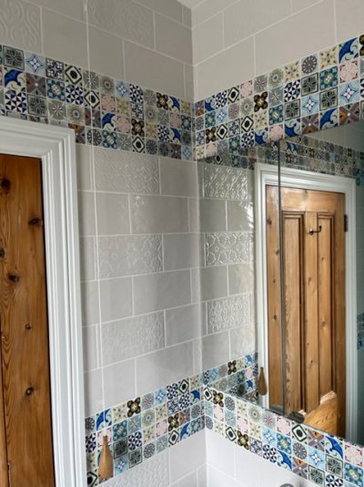

You can see the blue sealant and tape across the board joints and fixings, creating a surface totally impervious to water - if any moisture gets behind the tiles it should do no damage, especially with the sealing system used beneath the tiles around the shower tray. The green line is a laser - a self-levelling laser that gives you vertical and horizontal lines to work to is quite a cheap tool now, and very useful for tiling and other jobs.

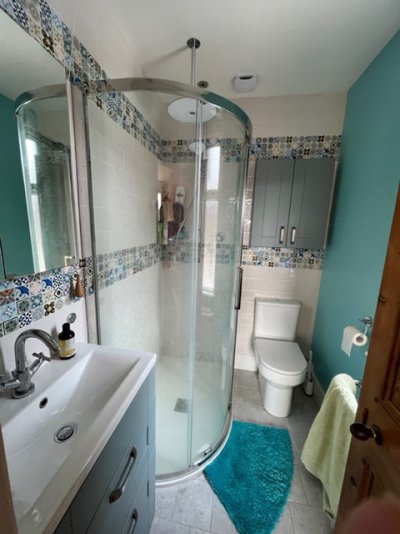

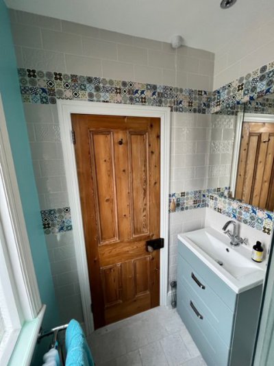

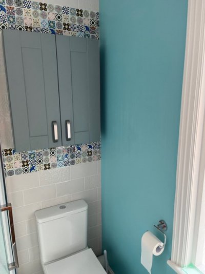

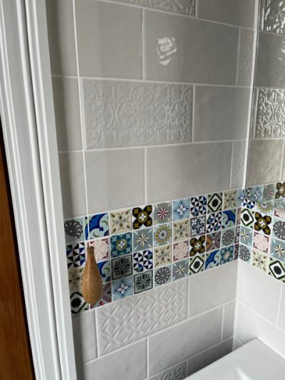

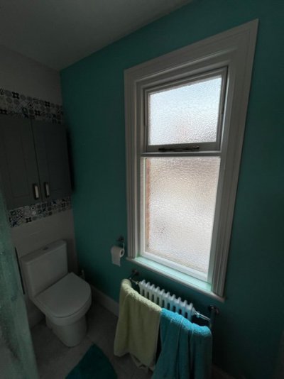

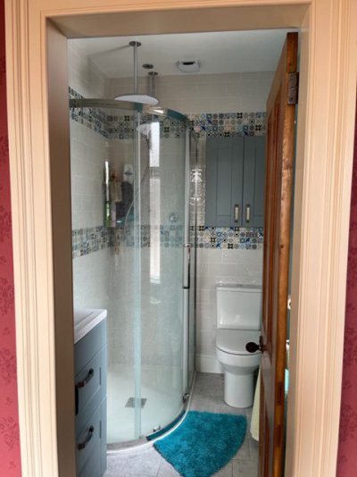

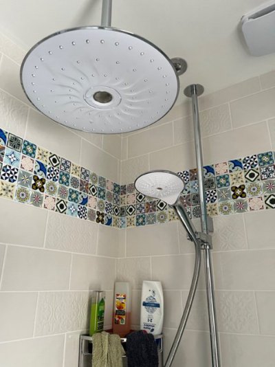

Fast forward to the end - hard to take pictures as it's such a small room, but whilst it's small it's got everything that's needed and it doesn't feel cramped. New post showing the finished room below, ran out of image allowance on this one!
