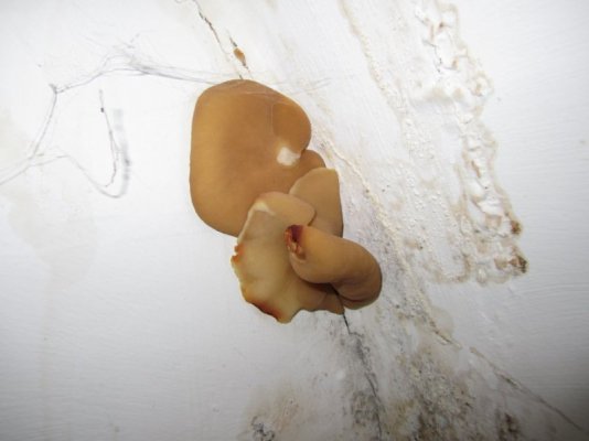

Where do you even start....? Rhetorical question. You start by correctly identifying the fungus. It's Peziza domiciliana, or "Elf Cup fungus", not dry rot. Take the lino up and let it dry out and resolve to open the window more often after having had a shower. Job done.
