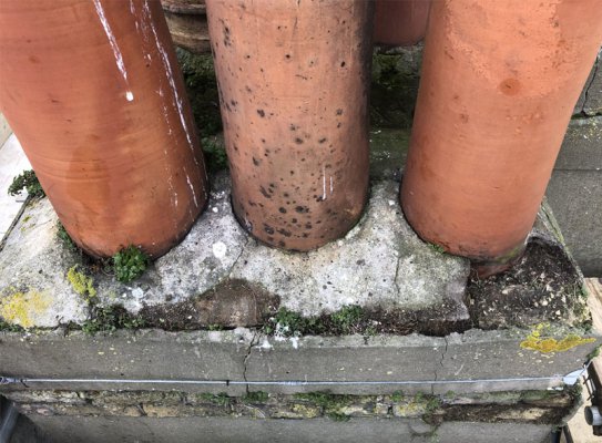

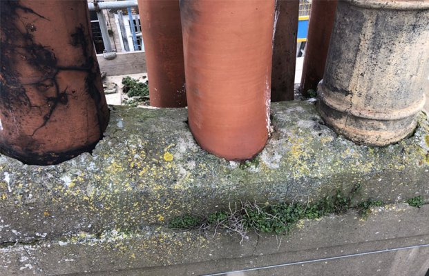

I am looking for advice as to how best we should proceed with what has got to be one of the most oversized domestic chimneys in Kent. We've known for a while that the render (sand and cement :evil: ) is a problem and that the flaunching around the chimney pots needs attention. However, given that the chimney sits in a valley between two pitched roofs and is probably about 5m from its base to the top of the pots we haven't got round to it until now. We've had scaffolding erected to give proper access to all sides so now we're faced with what looks like a rather daunting task. The chimney breast on the first floor is damp to the touch so we've known that there's been water ingress but with all the rain over the past few months it has definitely been worse.
I had a look on the weekend and the flaunching is indeed a real mess as you can see. The render is cracked in places and it's obvious that the bricks at the top are completely saturated.
What are your thoughts on how best to proceed? We were hoping that we could remove the render and re-render in lime once it has a chance to dry out but the builder we're working with has said that he's worried that removing the render will remove any structural integrity the chimney has and has suggested taking it down.
We would like to be able to install a wood burning stove and be able to be able (occasionally at least) to use one of the open fires but this is now looking increasingly unlikely.
As always I would welcome any advice.
Many thanks.
Scott

Hi Scott
My answer would be that those pictures don't tell you much at all and that you're just not going to know until the render is off.
The flaunching is nearly always knackered on chimneys that have had no attention, but it's really not difficult to replace. Here's the biggest chimney I've got here as a before - the flaunching was so bad it could be pulled off mostly by hand with no tools:-
And after:-
My advice would be take the flaunching all off, take the pots off, take the render off the top couple of feet and see what it looks like before you make a decision. Quite often a chimney will only need the flaunching and the top 3-4 courses rebuilding, unsurprisingly those are the bits that suffer as they're most exposed and see the worst water ingress.
Chimney thread on my house here:-
viewtopic.php?f=1&t=16671&hilit=chimney
And don't panic if a tall chimney moves a tiny bit when you give it a shove at the top - they do, especially if they're tall & slender like the one on the side of my house!
I have to say I'd always be against removing a chimney - they are so much a part of the character of an old house. Worst comes to the worst take down & rebuild, they're not complicated structures usually.

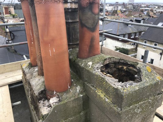

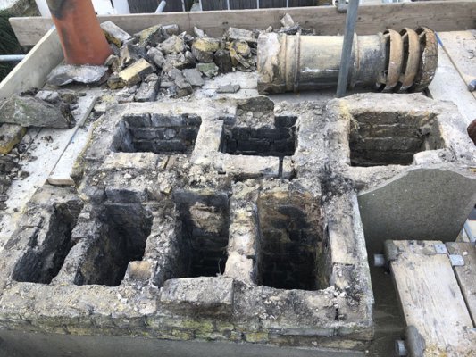

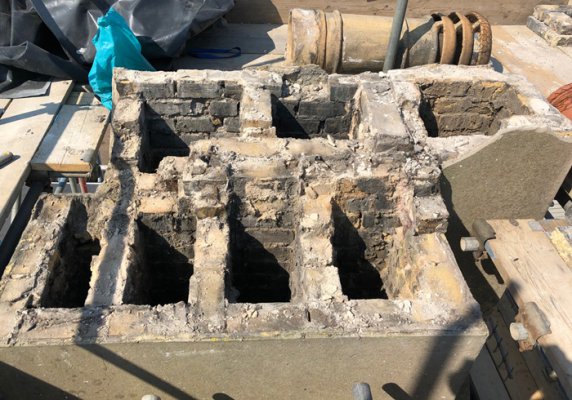

Thank you all for your advice and contributions. It has been very helpful and gave me the confidence to just get up there and have a look for myself. I'm glad that I did because saving the chimney pots was very time consuming and I'm not sure they would have survived if it hadn't been me doing the work. They're 1.2m tall and very heavy. The flaunching was made from a very strong cement mix so getting it off without destroying the pots took some time and patience.

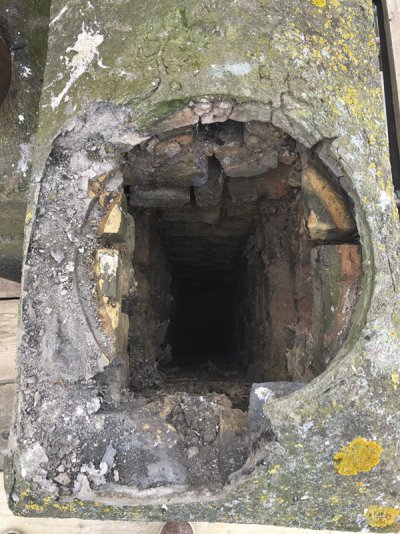

One of the pots was completely cracked through the middle and beyond saving. I'm amazed that it didn't just blow over what with it being four storeys up and so close to the sea. Three of the pots are completely intact, one other has a hole that I'm hoping can be patched or hidden under the flaunching and the final one has lost some of its bottom but can possibly be salvaged when we build up the chimney stack again. So 4.5 out of 6 is not bad, I think.
Unfortunately, the state of the stack is pretty dire. We managed to take off about 6 courses of bricks after removing the pots and we were still finding matts of roots between each of the bricks. It has obviously been several decades since someone has been up there. Where we were able to remove the render it took the face of the brick with it. They are really beautiful yellow stocks so in its day this chimney stack would have been stunning. So sad that it has now come to this. We still have a bit over three metres of chimney so we're hopeful (perhaps naively) that we'll get to a sound substrate at some point and the stack can be rebuilt from that point.
Interestingly, one of the pots was connected to two flues (bottom left in the attached picture). We're assuming that this is the flue for the original Georgian range cooker that is in the cellar but I don't know why this would be. Some insight would be most welcome.
Thanks again. As always this forum is a brilliant resource. I'll keep you posted on this latest ongoing saga.
