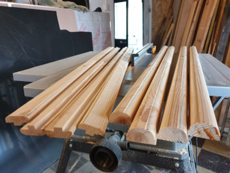

I've started mass production today. It's a lot of fun. Of course I'm being extra careful with the dangerous saw and table router and am well informed about safety precautions and don't want to be anywhere near a hospital!
http://www.the-salutation.co.uk/blog/wp-content/uploads/2020/03/20200330_155535-450x338.jpg
