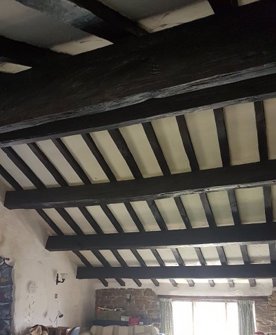

Hi All
I live in a late 1700's weavers cottage, The top floor (used to be the working area) currently serves as a bedroom/playroom. Trouble is it's not at all insulated - a layer of plasterboard, roof felt then the slates. It gets very cold in the winter (despite having 4 large radiators) and very hot on a warm summers day (infrequent as they are).
I'd like to get insulated, I've seen other houses in the areas with insulation/plasterboard fitted between the large beams, presumably fitted to the underside of the smaller timbers. I did wonder about insulating between those, although that would be very difficult to get acceptable snug
Obviously this will be subject to the usual building consents, but my biggest concern is how this can be done so as not to damage the timberwork, moisture being the main risk. Does anyone have any thoughts on what would be involved? Would we have to take the roof off and fit breathable felt? Would insulating between the beams be viable?

I've seen other houses in the areas with insulation/plasterboard fitted between the large beams, presumably fitted to the underside of the smaller timbers.... my biggest concern is how this can be done so as not to damage the timberwork, moisture being the main risk.
You're right. I have seen houses insulated like that and in most cases I think they are storing up a damp problem for the future due to the lack of ventilation around those beams. I don't know the answer, which is why my house (with flat ceilings) has lots of sheepswool over the joists in the loft which is well ventilated - a "cold loft". However, it is warm!

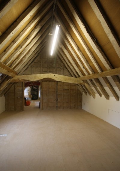

I faced a similar dilemma with our C16 G2* timber frame house with three large attic rooms. In one respect I was fortunate in that the roof was in a very poor state and had no membrane so I was effectively forced to strip the roof anyway. To make the attic rooms more habitable I wanted to create a 'warm roof' but I also didn't want to cover any of the attic timbers. Because of the gable parapet wall I had some scope to raise the roofline but obviously wanted to minimise and increase.
In consultation with our CO (obviously!) we settled on boarding over the entire roof with 9mm marine ply, then covering the ply with 30mm of Tri-iso Super 10 multifoil insulation held down with 25x50mm counter-battens. A breathable membrane was then fixed over the counter-battens and new tile battens fixed to the counter-battens and the original pantiles replaced on top. The total roof lift was about 60mm, which was easily lost in the gable wall detailing so that the finished result is indistinguishable from the original . . . well, from the outside anyway. From the inside it's no longer to see the sky through gaps in the pantiles :wink:
Multifoil insulation could be considered a controversial choice depending on who you talk to, mainly because some people are sceptical about its quoted insulation performance figures. However, I was not aiming to meet any building regulation requirements, only to massively improve the habitability of the attic rooms in question. In that respect it has certainly been successful.
