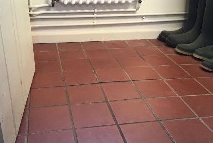

George - The floor was moving before the hollies came down and it's been a very gradual process. They were also sitting at about 2ft above our driveway level behind a retaining wall. I have a feeling it might be the toilet piping under the floor although there is very minor bulging at the other end at the other end of the cloakroom so no answer for that. I'm ignoring that bit for now.
I've attached a photo. The toilet is immediately behind the door.
