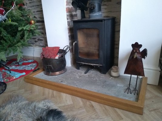

Post by steveb » Sun 27th Dec, 2020 2:22 pm
This is a hardwood trim just mitred at the corners and hollowed out on the inside so that a lip overhangs the edge a bit to hide any unevenness.
This is a tadelakt hearth not a tiled one and is a bit more raised than yours, but the principles I assume would still hold.

Exactly - there are two basic options here. Either minimise the height difference by fitting a small filler piece planed to the height of the tiles, or go for a more traditional fender such as the plain wooden one illustrated. This would obviously emphasise the join rather than minimise it. A nice brass fender would go well round the hearth illustrated.

The hardwood trim that Steveb posted a picture of is like what we have around our tiled hearth, similarly hollowed out on the inside bottom, and on ours the inside faces are also lined with brass.
Having just the other week replaced the 4 inch square quarry tiles, as quite a few were cracked, I'm pretty sure it's a period way of doing the trim, as it fitted exactly, and the listed marble surround was fixed on top of some of the old tiles.
