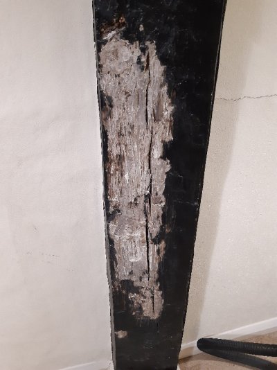

Hi there, some advice, please. We have a small number of internal timbers, some of which have been plastered smooth, some seemingly painted in a thick semi-shiny goop. I had a pick at one timber as attached with a scraper, nd the over-plastered parts came away easily with the paint, however I am now stuck.
I have got some Peelaway 7 test patches on the go, they have been on 24 hours and have removed a layer or so but they're not back to the wood yet. I've read it can take up to 72 hours so am not entirely giving up yet...but am also aware that it may not be totally effective on pre 60's paint. Our property was renovated and listed in the early 50s. I understand Peelaway 1 can darken and stain oak so am steering clear.
So my question is, if the Peelaway doesn't work, what is my next option? I do not want to go down the blasting route. We only have 3 or 4 timbers on our landing so I don't mind if it's hard work/slow going. Is gentle sanding acceptable? I think I will need to sand anyway as the exposed timber is very rough.
I also wondered about Klingstrip - if Peelaway doesn't work does that mean Kstrip won't either? I have also read that it can stain/darken, which is why I'm avoiding Peelaway 1.
All advice gratefully received....

I've seen recommendations for soda "blasting", rather than sand blasting. Seems to remove the crud but leaves the wood intact (including things like carpenters marks) as long as the operator knows what they are doing. If you can bear Facebook, there's a group called Listed Building - Owner's Group whose members could probably recommend someone in your area.
I wouldn't sand, as you'll strip any features and leave the wood too smooth (my friend did their beams, badly).

Get the beams ice blasted then. Nowhere near as much mess.

No matter what, get rid of the paint. It contributes to the decay of the timber and can cause major problems.
I would try to avoid basting, with any material, as this can and will remove the more delicate fibres of the wood from the surface grain structure and can leave surprisingly large grooves in the timber - think of a piece of driftwood you might find on a beach.. It can also do serious damage to the surrounding plasterwork. Its a pain in the rear by the best way I have found is to abraid the paint surface using a very coarse sand-paper and then to use a steam cleaner to dampen the wood surface below the paint. Having moistened the wood in this way the paint will be easier to remove with a scraper and if necessary a wire brush. You will need to be carful though as the wire brush can also strip out the softer wood fibres.

What about using a heat gun? Peelaway 1 is very effective, but is caustic. It certainly discoloured a sapele window sill and make it very dark so not to be recommended on oak. Good on pine though. Also old paint might have lead in it so avoid making too much dust.

Probably sound advice for most previously painted timber! And technically the only legal remedy for listed properties without having a chinwag with your CO, which may or may not be a pleasant experience.
But if the paint is flaking and the surface is friable, then one may still desire to prepare a sound base for fresh paint, which necessitates removal of the old paint!
But yes, dobbing over with a large emulsion brush something matt in white and black is slot less hassle, if slightly less aesthetically pleasing.
