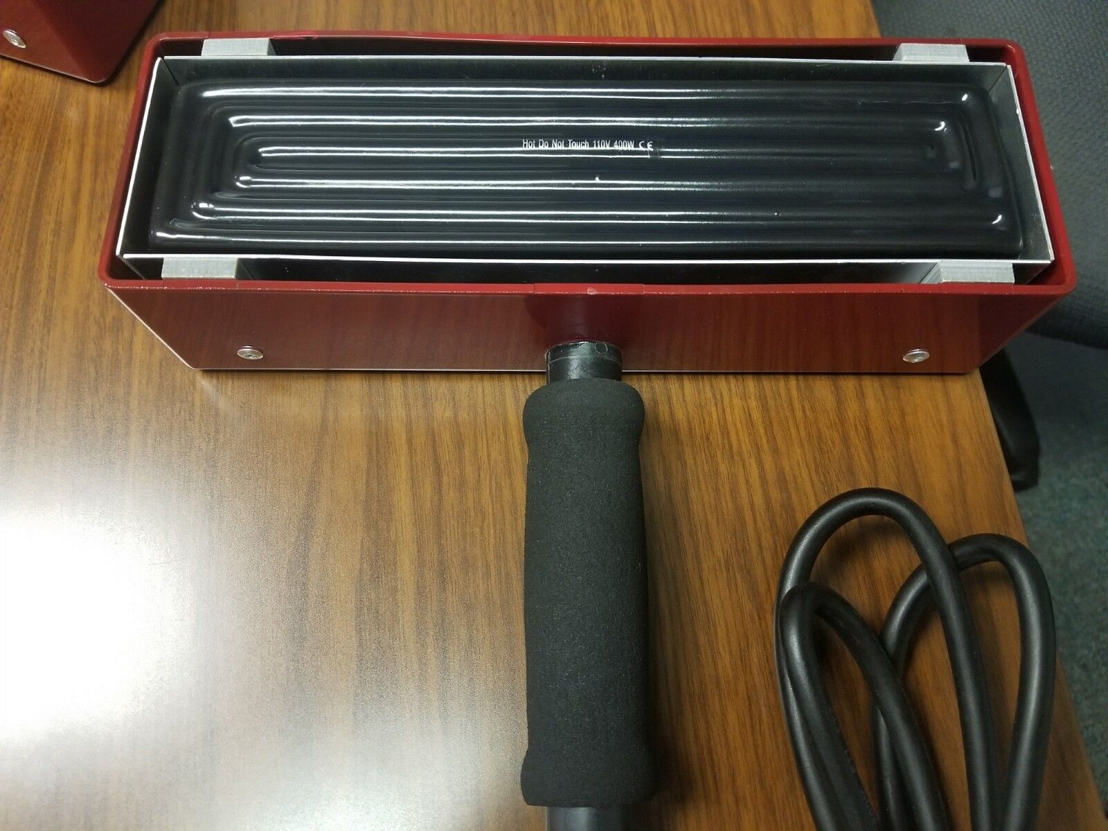

In my random surfing I have just come across an infrared heat lamp similar to the putty heaters:
https://www.ebay.co.uk/itm/Speedstrippe ... 4291718137
Only £35 each so I have bought one, will see what it is like when it arrives.
I don't know what it will be like but I know the real ones are expensive / rare so I thought I would share here incase anybody is interested.
(They also rumour limited stock.)

Its an infra-red heater used for heating paint to scrape it off and to soften old glassing putty to help remove it.
Zebra wrote:
Wed 13th Jan, 2021 1:29 pm
Does it say 110V on it?
Not noticed this :roll: It's apparently UK made and a UK retailer so fingers crossed its not.

Hi All,
Just arrived and I can confirm that it is 240 V and fitted with a domestic UK plug.
Happy days :D
Seems quite well made, simple design / construction (in fact you can buy the IR elements from fleaby for about £15) but looks and feels like it will get the job done.

Christmas holiday over so on to the next room.
I know I wasn't planning to use the heat lamp but the creative director decided that a built in cupboard needed stripping.
Not glassing putty but still gave it a good work out. This is multiple layers of very thick paint.
Before:
Once the tool is up to temperature it only takes about 20 seconds to heat an area but it does take a fair while to reach optimum working temperature.
It heats up an area 200 x 50 mm.
Once heated up and blistered.
Then a first scrape but so much paint it clogs the scraper and the working area cools quickly so needs a quick reheat.
A quick reheat and all done.
Overall very happy, even if I only use it for paint I am happy. It is a lot more controlled than a heat gun (and quieter).
