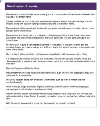

Hiya,
We just got the report back from the heritage building surveyor the local timber framer recommended and it’s showing up the long list of issues we expected…
We’re now struggling with trying to work out how long we’d have till we have to address each issue, and what kind of ballpark we’re looking at having to budget for the do it all if we can spread it out.
We absolutely love it but don’t want to end up half way through and not being able to cover it / we know it will be high, but don’t know how high and over how long!
Any guesses on this list much appreciated
