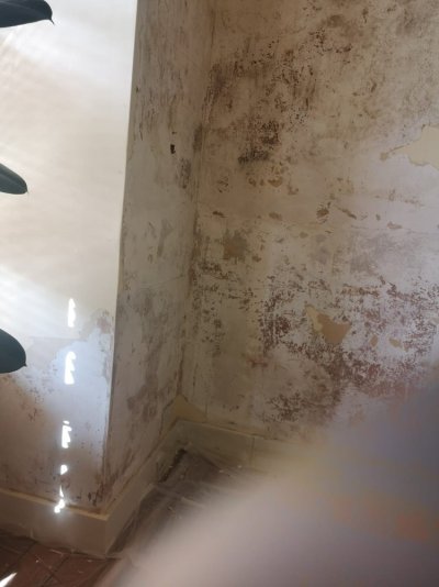

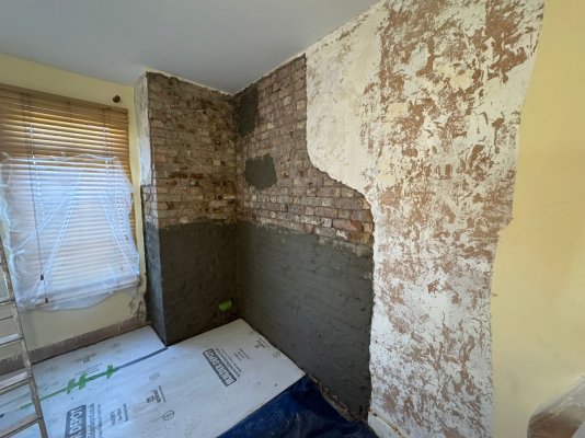

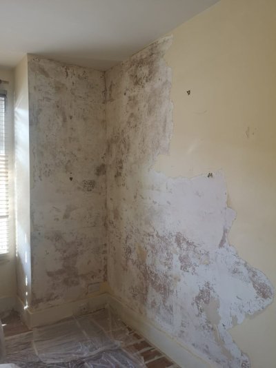

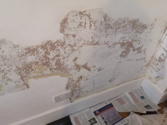

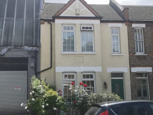

Hello, our end-of-terrace London house was built in 1902. On one side is a large warehouse that's used by builders to store their materials. On the other is my next door neighbour. We have damp problems downstairs on the warehouse side. We had damp in the front living room wall and we actually ended up removing all the plaster and taking it back to brick. The bricks were damp lower down the wall (from the front window and damp into the middle of the room. See photos). We ran an industrial dehumidifier for a few weeks. I wanted to re-plaster in lime to let the house breathe. My builder ended up injecting a damp-proof liquid into the bricks (internally), then he applied a waterproof slurry to half way up the wall and then replastered in sand and cement (he also checked the air brick vents, checked the gutters and drains. These were all fine). I said several times that I wanted lime plaster but he insisted that he had done slurry and sand and cement on a lot of London properties and never had a problem. I am fully aware that I should have used breathable materials, but my question is about the cold, damp warehouse next to my house. If tanking a period wall is a really bad idea, how should a damp wall be remedied if it is directly next to a cold, uninhabited, unheated warehouse?? I am aware that I need to try to contact the owner of the warehouse to get them to check the warehouse for water leaks etc, but if I can't get hold of the owner (or, in the interim) how am I meant to tackle internal damp with possible water ingress from the warehouse next door, or at any rate, the warehouse is never heated so that side of my house is always colder)? I think that a lot of advice on here about using breathable materials for a period property is either for a detached period property or a terraced house where there are next door neighbours either side. What's the advice for houses next to cold, uninhabited buildings? Please don't advise that I sell the house. My husband and I can't just yet. Thanks for your help.
