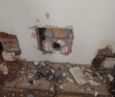

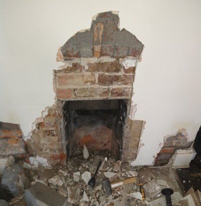

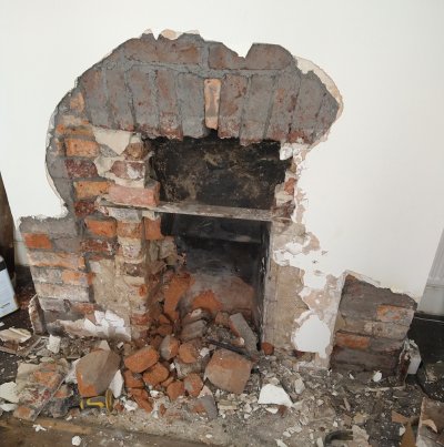

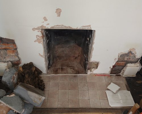

Hi all,
I am currently opening a bricked up fireplace in my Edwardian house due to damp, which is proving a challenge.
It seems that then the 1950's fireplace was installed, the Edwardian brickwork each side of the opening and the brick lintel was hacked, and then some sort of rock hard mortar was used to make the opening smaller with additional bricks. The same mortar was used to stick the T & R Boote Ltd tiles. The tiles had been plastered over when the 1950's fireplace was removed.
Is this normal (hacking the original brickwork back when 1950's fireplaces were installed)?
Because of the damp, a lot of the Edwardian brickwork has spalled and the mortar has disintegrated. Once I have completed the opening, I will let it all dry out.
To me, it looks like I'm going to have to get part of the chimney breast rebuilt, especially the brick lintel and sides of the original opening.
Any advice please?
