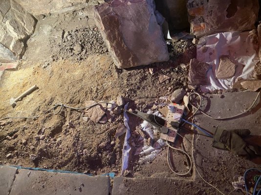

Originally there was a hearth built up and protruding about a foot from the opening, with a false wall at the back and the outlet from the woodturner going straight back into the cavity and no flu in the chimney, with consequent very poor draw (picture 1).

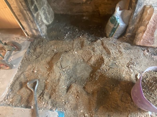

I have cleared all this material to reveal the original much bigger opening and dug out the fire place, which revealed bedrock under the rear wall and coming in significantly into the fireplace (pic 2 - areas of damp marked in red)

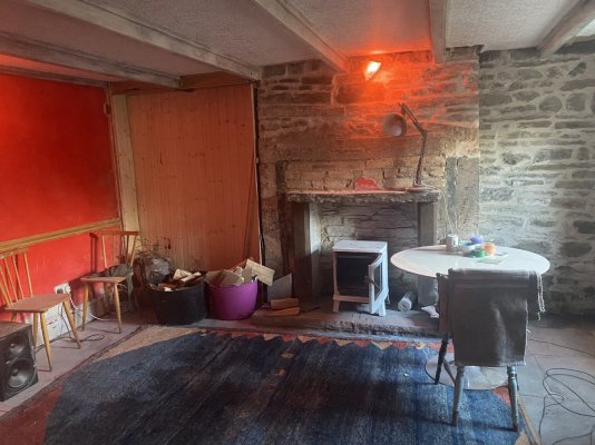

My original intention was to lift all the flags and remove the blue DPM that I am sure isn’t helping the flags breath and maybe forcing damp into the walls, then relay on lime (3 sand : 1 3.5N lime mix). I’ve lifted several flags where you can see hints of the blue membrane, as well as white sacking that’s been used… nice! (Pic 3)

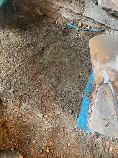

Although there is damp at the wall to the right of the fireplace and under the flags butting up to it, there was no membrane under them, though there are sacks being used as membrane in the next row of flags. However, there’s no sign of damp under the huge flag removed from in front of the fireplace that had no membrane, just gritty sand as the original substrate.

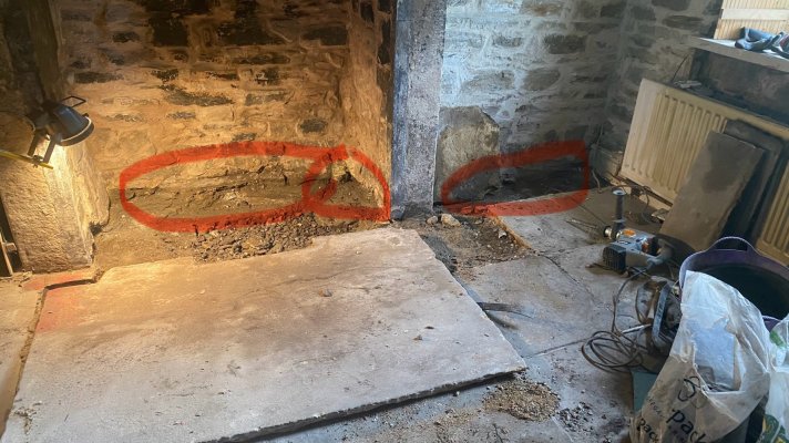

There is evidence of damp at the back of the fireplace where the bedrock is, so I’m wondering if the damp is coming in from the outside here and along the wall to the right of the fireplace? There is a narrow pathway outside behind this wall, but no French drain fro drainage.
