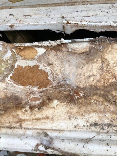

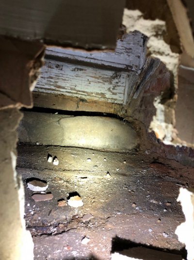

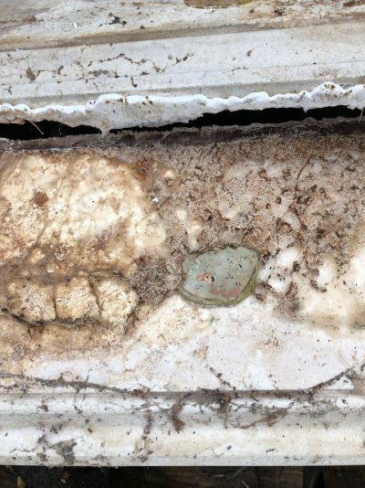

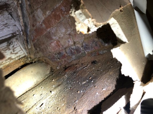

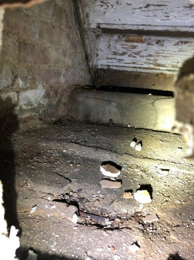

However, this led me to poke a hole through the plasterboard blocking off the sealed section under the first half of the stairs (where the mould had sprouted). Please see the attached pictures. There's some signs of mould growing down the far end, and there was quite bad mould growth on the removed skirting boards (pictured) in the accessible part of the pantry.
