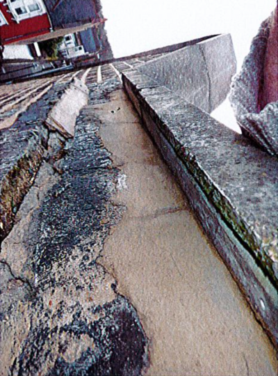

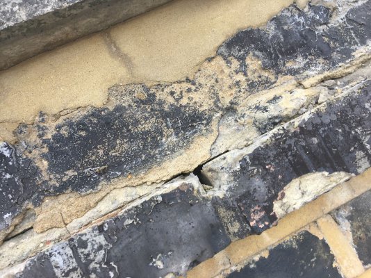

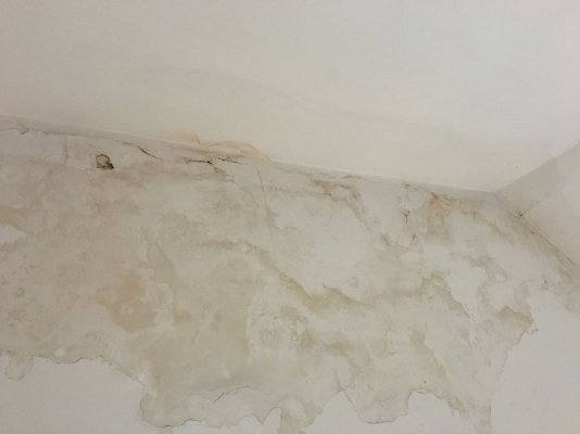

I have an area of wall below a parapet on a 1900-ish house, which in the past suffered severe water damage.

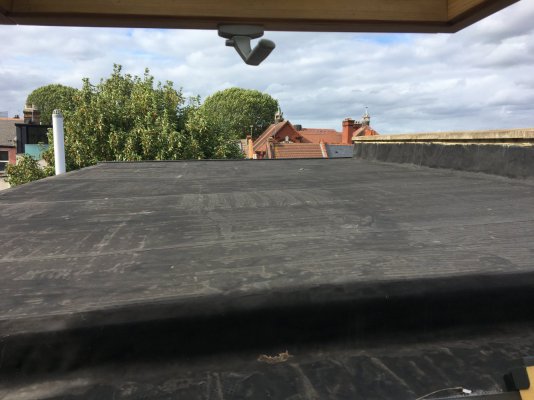

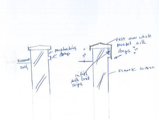

I have had a rubber flat roof installed, and the parapet is in better condition, although the roofers neglected to solve a problem which may be leading to further penetrating damp.

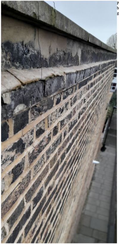

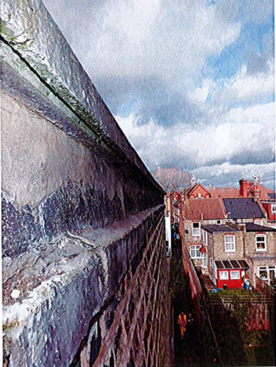

I've attached some pictures including a surveyor's suggestion. This is a second storey so will require scaffolding or a cherrypicker. Basically the soldier course looks in very bad condition and I think could be letting in water during heavy storms.
Internally it has looked terrible for a long time, and for a variety of reasons, including wanting to be sure the roof fixes had solved all the problems, I left off redecorating.
Now I am planning to get the vulnerable section above the soldier course, below the (twice weathered coping stones - they made a mistake there!) filled in and covered over as per the surveyor's recommendation.

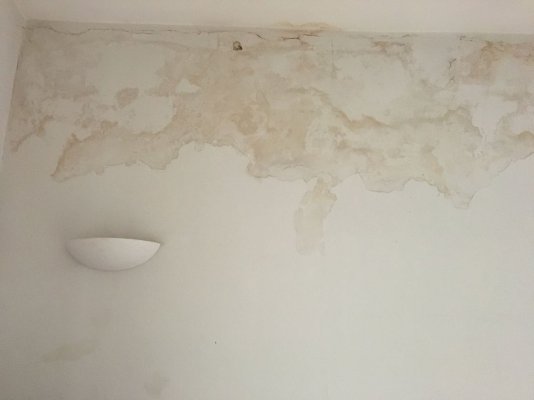

Once that us done I am wondering how best to deal with the internal wall. There looks to be quite a bit of efflorescence.
I plan to hire an internal scaffold platform and deal with this myself, hacking off the plaster back to the brick, raking out and repointing with NHL3.5, and then either attempting to lime plaster myself or getting someone in to do that.
I had considered a breathable tanking slurry to block any efflorescence, but not sure if this is the way to go.
How would you tackle a problem like this?
