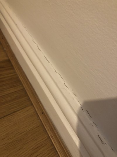

However this week I’ve noticed that a meter or two of the skirting board has very slightly come away from the wall and the paint has cracked slightly at the join (see pic). When I press the skirting board back towards the wall, the slight crack closes under pressure and moves away again when released. I painted the walls in August and so I know this is something that’s happened recently.
There is an ever-so slight smell of damp by this part of the skirting board. There is a slight raise and dip in the floor by the skirting board area, and also in the same position in the front room (marked on floor plan). They're not springy or spongy, but it is noticeable that the level is different and they make a noise when you walk over them.

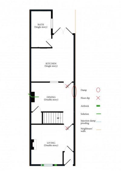

Please see the floor plan below, but it’s a small Victorian mid terrace C1860–1900, two up two down, with a full width single story extension at the rear C.1970. An injection damp proof course was helpfully(!) installed in the 1990s all the way around the property. There are plans of this in the house documents and you can see the injection holes outside at the front. The house is very cosy and dry throughout and rated C (probably due to all 4 fireplaces being blocked up – planning to open these up somehow to improve airflow in a few years).

Please see a floorplan attached with the location of the current air bricks, the skirting board area, and my proposed solution for venting bearing in mind it's a mid-terrace house.

3. Install ventilation vent in fireplace hearth to connect with sub floor (as suggested in above link), and any other possible location for another vent subject to builder's recommendation. At the moment this firepace wall is blocked up/covered over.
