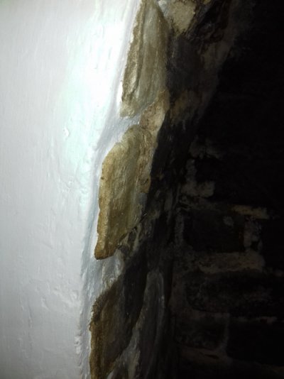

Our fireplace was bricked up by the previous owner. I've removed the majority of their handy work, but annoying they tied in their modern bricks to the existing coursework on the left and right front edges, so the two sides have a mess of chopped off modern bricks, smashed originals and cement filler.
I'm now contemplating whether to try and remove these odds and ends, put some reclaimed bricks back in and then repoint it all. (I have no experience in any of this whatsoever.)

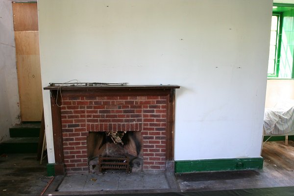

The fireplace will be used for storage or display items, and I'm hoping the finished result will look like this (but without a mantle or wood burner):
Do you think this is achievable for a novice?
If so what sort of lime mortar should I use? The existing mortar is very light in colour (under the soot), with small stones in it (you can see them in 2nd pic).
Some of the existing mortar is still sound, but some of it crumbles easily when you rake it with a screwdriver.
