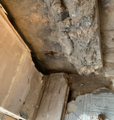

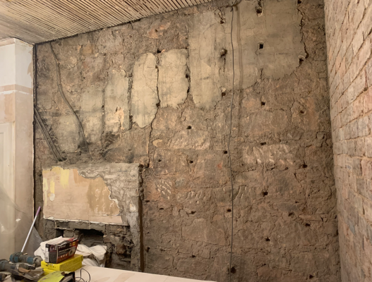

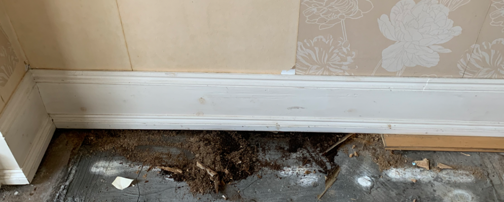

Basically the plaster has came away from 2 of the internal walls, if you pressed the walls the plaster moved with a ripple like effect over the whole wall. So we're back to brick on these 2 walls, most of the plaster came off without any effort at all, but the lower 30 cm had to be taken off with a SDS drill. It appeared to have been some sort of cement render, it was rock solid. When taking this off it has pulled some of the mortar with it.
Now sections of the lath & plaster ceiling are coming down.
Sections of the brick walls that had the cement render on look to be damp but the vast majority of the bricks look dry and apart from some missing/failed pointing look to be in good order. I'm assuming the damp areas are due to the cement render not allowing the wall to breathe and they'll eventually dry out now the render has been removed.
So my dilemma is how do I make good the dining room.
As the ceiling is staring to fail and there are no original features do I pull it down and sheet with plasterboard?
For the walls do I build a stud and sheet with plasterboard?
From all the posts I've read, I know I need to allow the building to breathe, so will the building still breathe behind the stud wall?
Or should I get the walls re plastered with Lime? Or is using Lime plaster pointless as the 2 remaining walls in the room are lath & plaster but with a gypsum skim and therefore not able to breathe?
