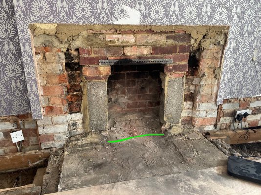

I’m mid renovating my living room. I’ve ripped out old floor, skirting, and out-of-character fireplace surround. Now looking to install log burner with characterful fireplace surround. Would really appreciate any feedback on what I believe is the correct flow of work here. I won't be DIYing it - job for the pros.
Thanks!
**Scroll down for photos**
- Get the lower stack rebuilt, fully secured - looks like it needs a dam good rebuild to me
- Job for a joe bloggs builder or specialist builder?

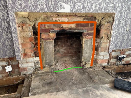

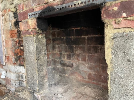

- Basically how do i determine the opening size? Perhaps i can go as far as the perpendicular internal side wall (see 2nd photo then the 3rd photo with orange outline). Then add a lintel above. It's a 46m3 room so probably needs sizeable log burner.
- Does this 'stack building work' require any building regs notifications or other certificates of compliance?
- Make good the building work e.g. plaster and touch up where needed around the opening
- Installation of hearth and then log burner
- Perhaps the floor could go on first up until the opening (see green line on first photo?) and then lay hearth over floor? (will look neater imo)
- log burner will be installed by properly certified company with all regs notifications etc.
- Who should i expect to cut and install the hearth? Same people who install the log burner or someone else e.g. joe bloggs builder?
- Fit new flooring
- Fit fireplace surround (i'm guessing i need to ensure i don't create an opening size that requires a bespoke surround to be built? ideally id get reclaimed)
- Fit skirting boards
