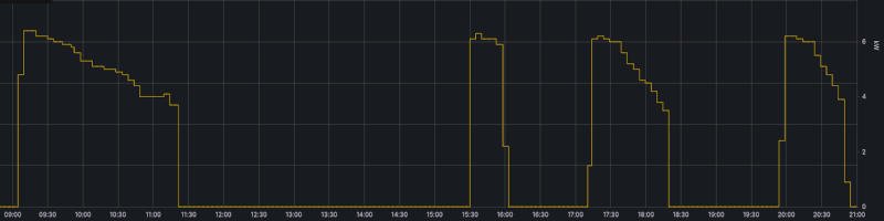

I scored a rebadged 1.5m³ L&G T230 on ebay for the princely sum of £18. An MBus to USB converter from China coupled with some simple software allowed me to integrate it in to my Home Assistant system. You don't need to set up a computer to log the data as energy & volume can be read just by pressing a button - Just like reading your gas/electricity meters. But if you do record the data, you can produce graphs showing energy used throughout the day. e.g.:
