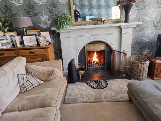

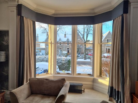

Hello, I am thinking of getting a stove installed in my living room. The room is pretty big – 5m x 7.5m and a 3.5m ceiling height. It has single glazed sash bay windows approx. 9ft high. It’s never been that warm and the gas heating struggles to cope with the extreme weather we get here in Scotland. By my own calculations, the stove, for that room,  should be in the region of 10kW. The issue is that the installer that I have spoken to says that to adhere to regulations and for a stove of that size, and for any stove over 5kW, he’ll have to knock a ventilation hole in my outside wall! I realise that this might be appropriate for a hermetically sealed modern house but my house was built in 1890 and is draughty as hell. Has anyone any experience in this?
