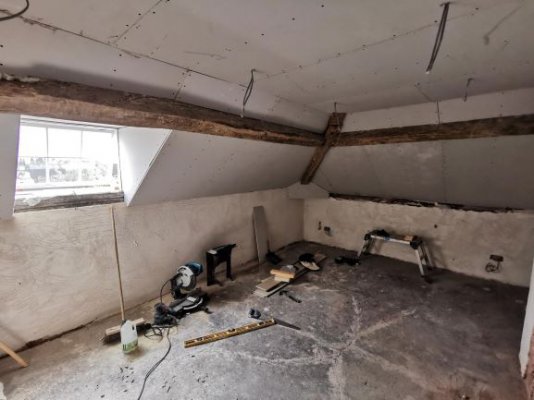

I have finally started work on the top floor of our house which has three 'attic' rooms. My first job was to relay the lime ash floor on the landing that had broken up. Now that the access to the other rooms is safe, I have more work to tackle in each, starting with the smallest!
I would be interested to know your thoughts on the following:
1) The lime ash floor is not in great shape in this room - it's cracked and very uneven but generally sound. I can't really justify relaying it and really wouldn't want to crush and relay another lime ash floor ever again! The floor does need some protection and wondered whether a thin sheet material such as ply or hardboard might help to spread the load of furniture and foot traffic under a carpet. Does anyone have any suggestions?
2) The external walls have been replastered with an insulated lime plaster. However, there's a small strip unplastered where I have been monitoring leaks around the wall plate. I think the leaks are fixed for now (that's probably cursed it!) and wondering the best way to plaster over the timber. How is this normally achieved?
3) The beams are not in great shape. I have a small section of wet rot to chop out and splice with new timber but then the question is how to finish the beams. I've deliberated over this since we had these beams dry ice blasted - although they're probably the best beams we have, there's a lot of beetle damage and I'm swaying towards filling and repainting rather than cleaning up and waxing. Any recommendations would be much appreciated.
Thanks in advance for any help you can offer.
Matt
