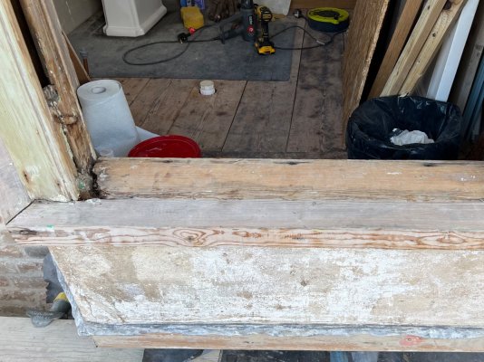

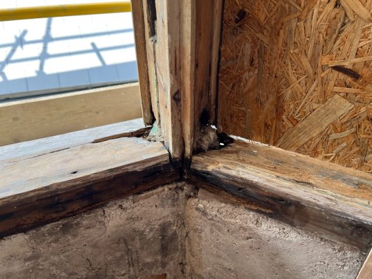

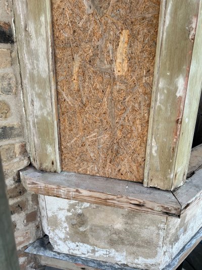

We have two first floor bay window cills that need sections replacing as the repairs over the decades have allowed for serious rot to set in. We have had matching cill profiles machined by a local timber yard so I am hoping that the perished sections can be cut out and replaced with new timber.
We are having a nightmare finding someone to undertake this work for us so I am now contemplating doing the work myself. I would really prefer to have someone experienced doing this part of the renovation of the bay but the weather is getting cooler and we would like to get the bay painted and the sashes refitted before winter.
I have attached a couple of photos of one of the bays showing part of the rotten section of the cills. You can see where someone in their wisdom previously used cement as filler!
I am thinking of starting by cutting out the rotten section back to good timber on a 45° angle and splicing in the new cill. A reassuringly expensive amount of two-part resin wood filler can then be used to tidy up the areas that need it. My experience with this long suffering house tells me that it will likely not be as straightforward as that so any advice would be most appreciated.
