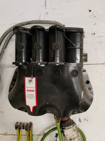

It's difficult to get a scale of the thing and - of course - we don't know the rating of the cutout but those tails (the wires coming out of the top) look a little thin to me?
Wha, sorry? Oh, yes, that's the service head, the joint between the incoming cable owned by the electricity distributor and the meter tails. Every property has one. Onto the bottom of it is your main earth (green and yellow wire), which means you have a TN-S incomer (earth and neutral separate) rather than a TNC-S (earth and neutral separate in the property but combined within the incomer), this wire is very important, do not remove it.
I assume your main fuse (mentioned by Stevers) is separate.
Basically you can't do anything with this thing, the service head. It's owned by the electricity distributor, as are the cables up to the meter. Even if the cables out of the top of it do look thin, it's not down to you or your electrician to change them. Incomers often are thin, way thinner than the legal requirements for the cables after the meter, which you do own, but that's just how it is.
I have occasionally moved a service head a bit - both in my house or someone else's - but only a short distance and without opening it up and (obviously) without shutting it off.
