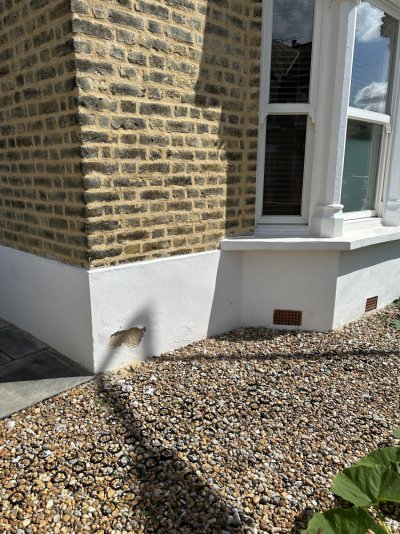

In 2022, my Victorian house had lime repointing plus lime render skirting with 2 coats Earthborn Eco Pro white mineral paint system incl. primer.

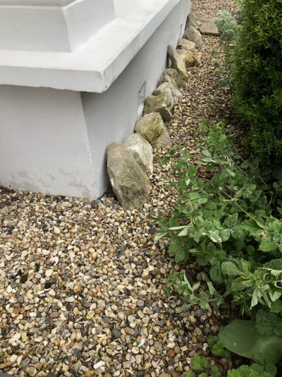

I’ve had the builder back a few times to repaint the white skirting area around the bay window as it bubbles and flakes off. (Pics 1&2 are my house.) This year she has recommended removing the black weed mat under the stones as she thinks water isn’t draining away quickly in heavy rain although there is a slope away from the house. She suggested getting large flagstones (pic3 is her house) to stop rain dripping from the windowsill to the wall. Do you think this would help?
Pic2 shows the paint flakes off in a section away from the windowsill too. She has also suggested smaller pebbles might reduce rain splashback.
