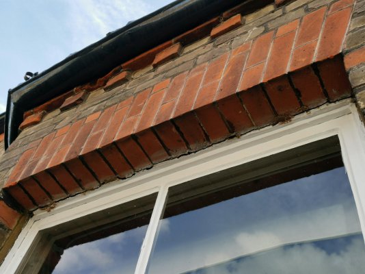

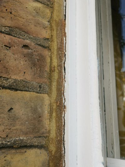

I'm repairing some gaps around various sash windows - and mixed my first batch of Burnt Sand mastic
For Horizontal work - Its easy to use - for example on the stone cill to prevent water creeping under the Wood Cill
For some of the vertical work; - the very narrow gaps in the second photo it can be made to 'go on' (Ive ended up using my finger to push it it, then cleaning up the 'loose mess' with a brush
(Some form of piping bag might work here)?
From the first photo - For the overhead vertical - I've not had any luck - Gravity is winning
I'm using a 4 Part by volume paving sand to 1 Part Boiled Linseed (Thank you to @Feltwell)
Is this type of crack 'too big'
Is there a different mix ratio I should try
Or possibly another additive to create a 'stickier' mix
Or is this a job for a mortar of some type?
I'm going back out to try again, and will use a hawk or possibly a long flat piece of old parting bead, and load the beads with sand mastic and push it up into the over head gap
