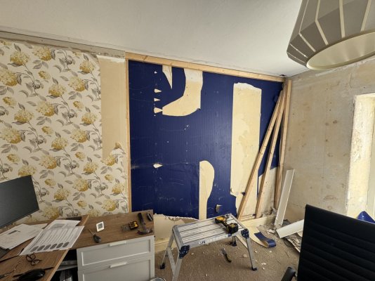

Apologies for another one of these threads. I did some digging but most seemed to be wanting to actually use the fire.
I was just looking for any advice I could get first of all on how to correctly size and then whether fitting was a simple case of push in and secure if I’m just wanting it for decoration?
I’ve read stuff about back filling, is this necessary if it’s not going to be in use or is it a building regs thing for safety that it has to be fitted so it could be used?
I’d also really appreciate any help I could get on getting the correct size. It’s for a bedroom and I took some measurements:
Full width minimum (to cover exposed brickwork)110
Height minimum (to cover exposed brickwork): 112cm
Internal with widest: 55cm
Internal width narrows to: 21cm
Internal opening height: 90cm
Am I right in saying I just look for a surround at least those dimensions or bigger and an insert that’s a maximum of those dimensions or smaller? Can anyone tell from those whether it’s a standard type I’d be looking for? Preferably I’d like an all iron, not tiled look but open to suggestions.
Pictures taken today after stud wall taken down:
