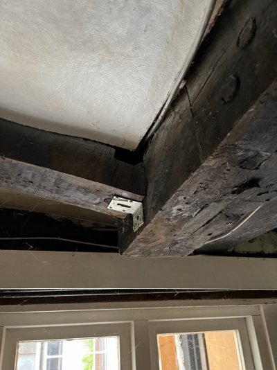

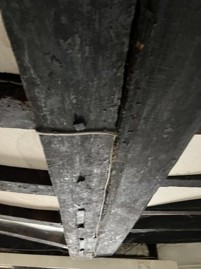

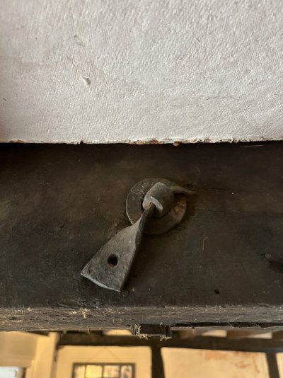

This would usually be my approach. Our current project is testing my limits a bit more though… the early spine beam here no longer lands on the gable (different longer story!) so rather than repair, the Georgians decided to add another spine in and replace one half of the joists, holding up the other side with a single wrought iron bolt. Thankfully some later occupants realised this error and added a small metal bracket with 20mm screws to keep things in check!!Has the ceiling fallen down in the >100 years it has been being held up by this beam?Are there any recent signs of deformation or cracking?
If the answer to both is no then it’s probably alright then
Hard to tell from the images, but that ceiling certainly hasn’t been there 100+ years, looks like gypsum skim on mesh. Also looks like it might continue over the top of the beam? Which would make me wonder if the timber is functional at all or just possibly decorative/redundant. I’m guessing the floor joists above are carried some other way. I can highly recommend the structural integrity of spiders webs …Has the ceiling fallen down in the >100 years it has been being held up by this beam?Are there any recent signs of deformation or cracking?
From what I can see, no. But that has obvious caveats!Thanks all! Silly question but this beam doesn't look like it's been fire damaged has it at some point does it? I only ask as it's super dark

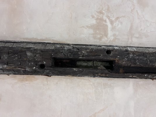

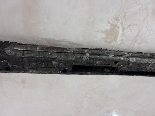

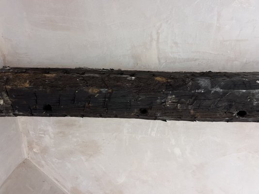

Yes, anything sharp would remove some finish to test how easy it is to remove, but a chisel is the wrong tool. Also these beams are incredibly cracked, worn and worm eaten, no finish is likely to be easy to remove unfortunately, even if it was coated in poster paint, but agree, they look like a lower build to yours Kearn, which from the variable sheen looks like they could be coal tar.From what I can see, no. But that has obvious caveats!
Looks much like a dry surface coating, which if you’re lucky will come off easily compared to bitumen or other muck. Try scraping a section - an old chisel will do if you haven’t a scraper. The surface marks are a key for when it was plastered over.
How old is your property? Try a search I have repeated this dozens of times, I really should write some new articles.Why would someone have put coal tar on them? I’ll have a go with a scraper and see how I get on. Is the coal tar usually fairly superficial?
Can’t upload a poc from our place, size is too big which I thought was a distant memory on this site! However, the cuboid cracking is indicative of rot plus black painting makes it look charred. I have exactly the same on a section of sole plate…Thanks all! Silly question but this beam doesn't look like it's been fire damaged has it at some point does it? I only ask as it's super dark
