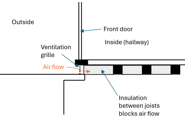

I purchased a Victorian terrace last year. We have a fairly large cellar under the hallway to the front door (inc an original coal chute at the end, connected to a small cover in the front path). At some point, insulation has been added between the floor joists to insulate the hall floor.
However, we have now realised that the cellar is pretty humid (I do recall from the viewing the prev owners had a dehumidifier down there, but had forgotten). Having examined more closely, I have realised that there is a ventilation grille (maybe called a daisy grate?) below the front door threshold, which connected directly to the cellar. However, it is blocked by the insulation - see diagram.
Rather than just buy a dehumidifier, I was thinking of installing a few of these S-shaped ducts to restore the air flow into the cellar from the grate while retaining the insulation at the front of the hallway: https://www.manthorpebp.co.uk/wall-...rfloor-ventilation/telescopic-underfloor-vent
Is this a good idea? Anybody see any reason this would not work? I plan to monitor the effect with a cheap humidity sensor.
