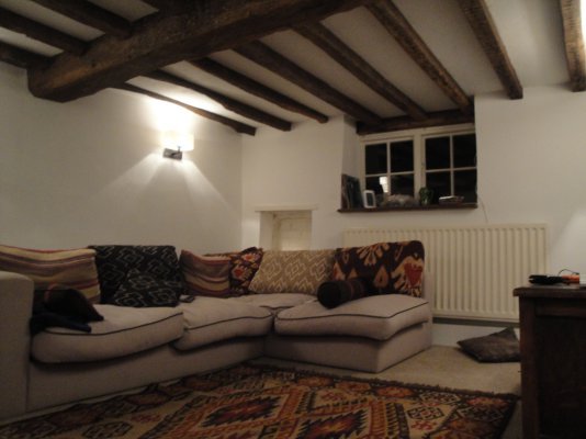

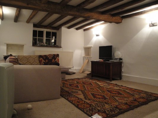

Not been on for a while, but just about finished our cellar refurb and thought i'd share pics. House was built c.1640. All walls are below ground level, but we're lucky in that we do have a window on one wall, made possible by a big scoop of earth being removed years ago.
It was used in the 1970's/80's as a lounge and as a damp measure the previous owners built a block work wall inside the rag and mud walls. One wall was left in mud and rag though.
When we moved in it was pretty damp down there. We had the usual quotes of c £8,000 for tanking/membranes etc. We decided to ventilate for a year and see how we got on. We fitted some trickle vents and a humidistat fan.
After a year it was feeling pretty good down there - the mud and rag wall was obviously still suffering from penetrating damp though, so we had this treated with a membrane - total cost of about £600 inc dry line over the top.
Usual stripping of thick layers of hideous dark wall paper and dark red carpets and replacing with netural colours changed the space completely.
It's by far the warmest room in house thanks to the tons of insulation provided by the earth! Perfect for winter.
