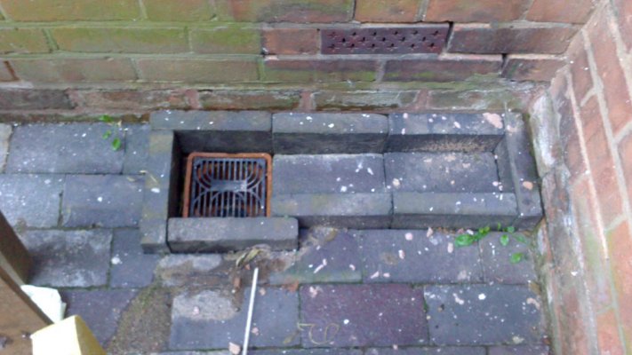

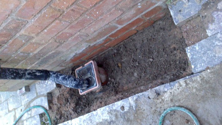

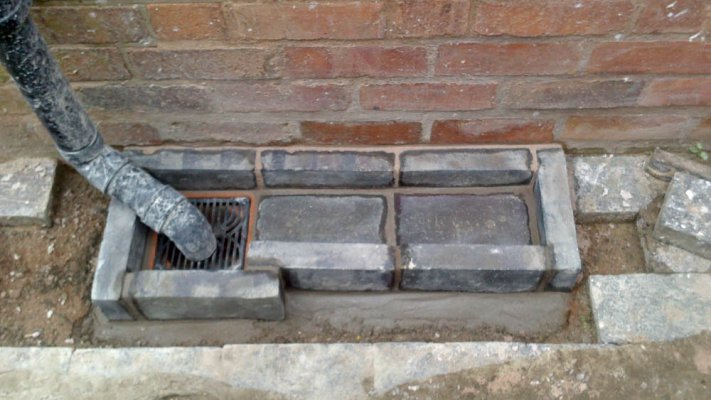

Hello. I plan to put in some edgings around a couple of gullys to contain the overspill from the bottom of the downpipe. I will be using blue brick pavers standing on their long narrow side so the face that is normally horizontal will be vertical. I plan to fill under the gully with something harder than soil (cement or hydraulic lime mortar), and bed the pavers into whatever I use. Should I use a hydraulic lime or cement for this. I feel cement may be better as it is more waterproof, but then again, I don't want to put cement against the wall of my house between the paver and the wall. Any ideas???
