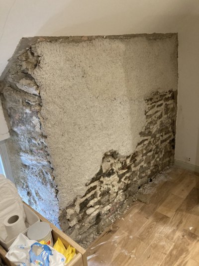

This weekend’s target, second bedroom, south wall. 3 - 5 layers of cement and gypsum. Easily 2 inches thick across most of the wall. Up to 3 inches in spots. Absolutely grueling  and catastrophically dusty (as usual).

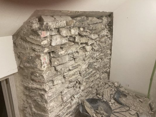

Tools used, SDS, hammer and chisel. Ready for dubbing out / rough repointing in NHL 2 and grit sand and then we’ll apply our homemade insulating non-hydraulic lime render mix.

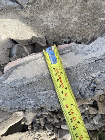

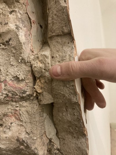

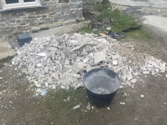

This must be what coal-mining feels like…
