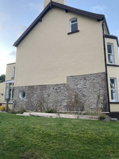

We bought a Victorian Villa and we have discovered that one of the walls was re rendered in cement probably in the past 20-30 years. We have some issues inside due to this, a couple of cold damp spots on the lime plaster. I have started to remove the render as pictured.
It falls off without much effort so going to remove all render from this wall and re-render in a more appropriate lime based render
My question is, can I leave the walls exposed without render until it can be re rendered in Spring/Summer?
