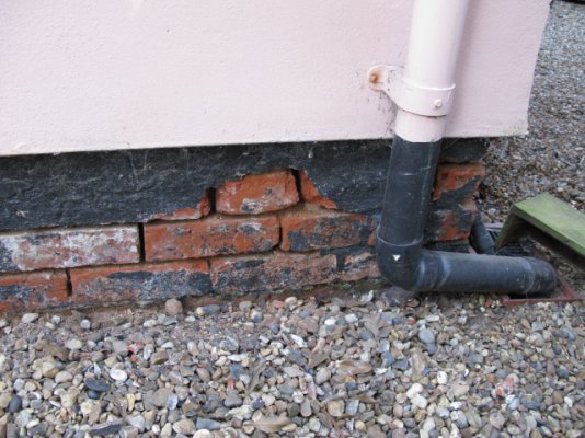

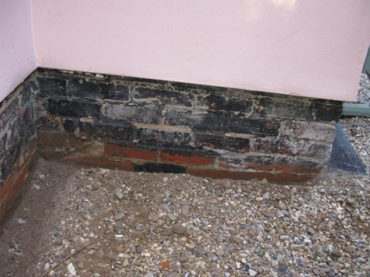

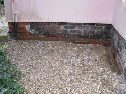

Well, I had a go at stripping the first section of the cement today. Too hot to do too much!. We have a cloakroom / bootroom that attaches to the side of the house and I had assumed it was a fairly recent construction. We are experiencing quite a high level of damp in there at the moment. The problem is we can smell it but can't see it because internally it's all dry lined.
The base of the wall (I think the whole wall is all brick but single skin) felt very damp and was covered in a mixture of bitumin and what I thought was cement render. You will see in the pictures that the wall is actually quite old and the various coverings have caused all sorts of damage. Where it is showing a big need for repointing (not rendered but bitumen coated) the old mortar came out like wet sand. No bonding at all in places and I could push a slim tool right through.
I tested a sample of the render and it did fizz in vinegar but felt like cement. It came off very easily and in pieces the size of dinner plates for most of it and the problem is that in most areas it was applied to brick already covered in bitumen :? . The render went into the ground and was saturated at the base. There was the usual distinctive damp smell when it came off.
The plan is to repoint but not re-render. I do though need to get rid of the remaining bitumen. Would NB510 sort this?
The plan is the lower the ground level all around the area by 4 - 6 inches which will clearly help the drying out process.
Any thoughts on this?
