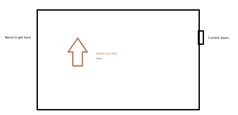

Can you not notch the joists?Hi all
I need to get hot/cold 15mm CH pipes from one side of a room to the other, and the moist direct through is through the joists. How bad is this? Would have to go through every joist.
1st floor room. Alternative is to run them around perimeter on skirting boards.
Thanks
