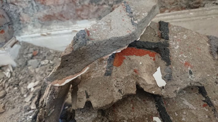

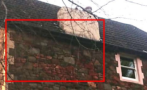

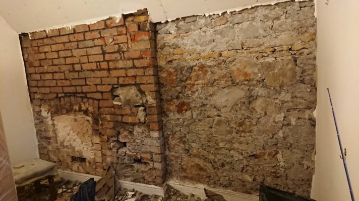

We had issues with the roof and chimney flashings causing damp that were fixed about 4 years ago by professionals. Since then one of the walls against the chimney breast has been suffering from major efflorescence, and was maxing out the moisture meter, I've removed the plaster on this wall. Now that the plaster is off there's a very obvious smell of damp and I can't tell if this is historic from the original leak and water being trapped or if there is still a problem with the chimney stack. Damp stop paint had been used on that wall previously to add to it's lack of breathability.
Is it essential to wait for the wall to dry completely before applying prooftherm/wood fibre boards considering as they themselves are breathable? I'm currently running a dehumidifier, fan and the heating in there (I've potentially picked the wrong time of year for all this). Obviously it's important that I'm confident any leaks have stopped first, I assume it's possible that water could have been trapped in there that long? Condensation used to form on that wall specifically before the plaster was removed. I'll use some Rempro salt neutraliser on the bricks, would this also be required on the stone?
The mortar between the bricks is quite crumbly in places, I've included a video of this. Could this be problematic?
