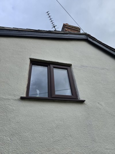

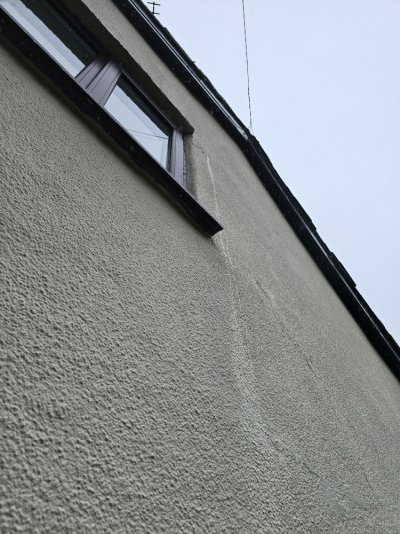

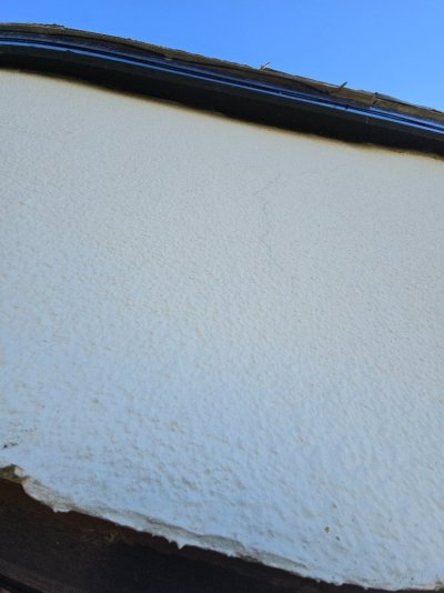

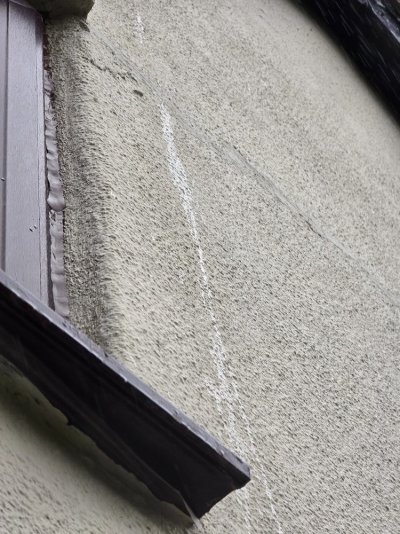

Looking at the pictures, would you have worried over headlap/sidelap on this installation?
I'd love your opinion on what could be improved up there as I will be looking to remedy that area soon.
