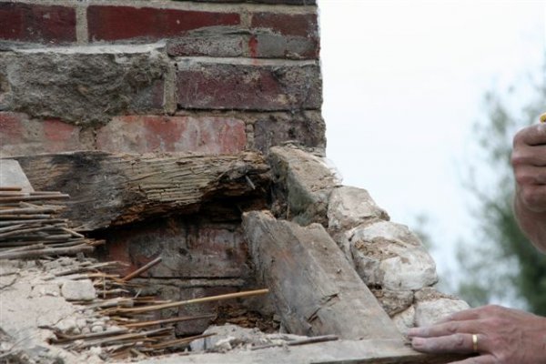

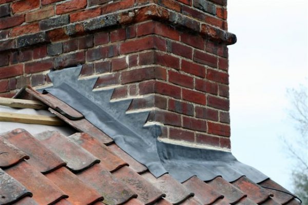

Last summer we had our roof replaced, with breathable membrane and slates. The roofer didn't put any flashing in. I remember the time he mentioned that the membrane tucks underneath the coping stones so no edge flashing was required...sounds ok and works fine....apart from working on the attic i've discovered a leak. It's coming in along the bottom of the chimney stack where his cement fillet has opened slightly. I'm getting back in touch with him but does it need a flashing? Traditionally what method would have been employed? When we moved in the roof was very old and didn't have any flashing.
