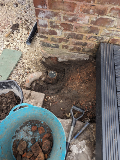

Our Victorian Semi has a cellar that was always completely dry. Over the years, when there was very heavy rain, we started to get a small inch wide trickle where the concrete floor met the walls.
Always in the same spot. It looks like there is either a deliberate gap between bricks at that spot, or the mortar has been washed away.
The amount of water has gradually increased and eventually has become a few feet wide leak. The floor is now always damp. Water also came in when we let a bath go. So we got the drains looked at and there were cracked and slipped underground clay drains. We got the problem pipes replaced and the sodden clay that was dug out replaced with MOT1 to back fill.
I now need to replace the patio area that I dug up prior to the pipe replacement. This consisted of a loose sub base of broken bricks, rubble etc and a concrete slab that was cracked in several places. On top of this were blue Staffordshire paving bricks. I have also found another suspect gully which I have excavated around it and there are many half and whole bricks with voids in between. Directing a hose in this area causes water to come straight through to the cellar.
I plan to remove all poor back fill and replace with proper pea gravel below the gully and MOT to bring up to ground level.
I then don't know whether to put concrete over the top and slope towards the gullies.
In my mind, if I leave a 12 inch border around the house wall of gravel over the MOT, water will soak through this and into the cellar again.
Any advice is welcome.
