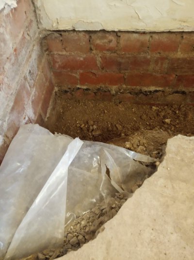

I have been investigating the rising damp in my Victorian mid-terraced house. All walls have the original bitumen damp proof treatment. In the kitchen I noticed that the 80's concrete floor has a dpm that is above the bitumen.
I suspect that damp is rising through the earth below the dpm and into the bricks.
Rather than digging out the whole floor, would it be possible to dig a trench along the wall, below the bitumen, and reconcrete with a dpm? - in order to stop the bridging.
The photograph shows a trial trench that exposes the bitumen layer. You can also see the dpm under the concrete. The earth I have dug out is not dry but farly damp. There are salts accumulating on the exposed bricks that were under a skirting board.
We also have original quarry tiles in the hallway that probably don't have a dpm - they are causing rising damp on the internal walls during wet weather.
You can also see where the quarry tiles meet the kitchen concrete.
These tiles were covered and sopping wet - they dried out really well during the summer and damp in the walls dried out too.
Any advice would be gratefully received.
Thanks
