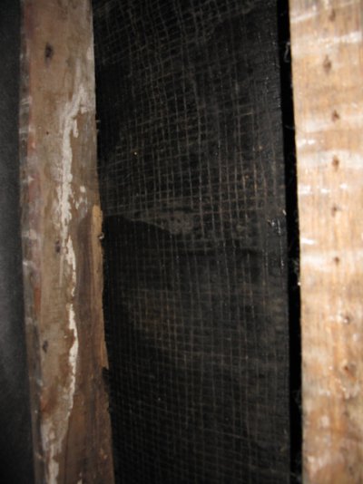

I have cement rendered timber frame walls that having ripped off the plasterboard are showing serious signs of rot because of condensation. Currently I don't have the option of removing the cement render and re-rendering. What is the best way to stop the condensation? Should I try and seal the cavity with an impermeable membrane or leave it more open to ventilate naturally? I would like to insulate between the beams at the same time. Is there a temporary solution (maybe 1-2 years) to preserve things until I can replace the render? Thanks!!
