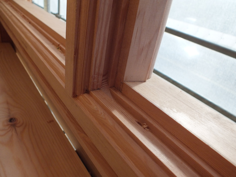

Here at Feltwell Towers - which is not listed - most windows are 2 over 1 vertical box sashes, all largely original, all single glazed. I have no intention to alter these, too many problems with conversion to double glazed units plus I'm not convinced on the benefits, so it's been restoration and draught proofing as I've posted about before.
However - the bathrooms are a different matter. Here we have small windows with a fixed large bottom pane and a smaller centre pivoting top opener, original to the house - but all require attention, all have some rot, and in one bathroom there is later obscure glass fixed directly to the inside of earlier outer plain glass, with lots of grot inbetween - nice!
Being prone to condensation for obvious reasons, even with extractor fans in the rooms, having double or secondary glazing seems a good idea. No room for secondary unless I went for fixed units - not an option, I want to be able to open the top windows - so I was looking at conversion to DG as a possible solution. I think you can do it without too much visual impact to the window.
I've heard you can get stepped units, where the outer sheet of glass is sized as per the original SG sheet, but the perimeter seal & inner sheet is smaller so it sits inside the frame, intruding into the room slightly. I understand that most DG unit failures are caused by the seal going round the edge due to trapped moisture - so - rather than fully bedding a unit on sealant, which would always make it prone to trapped moisture, my thought was to install said stepped unit with the outer face bedded and faced into the frame as per the original SG sheet - but with a modern putty replacement - but then with plastic blocks around the perimeter seal and inner sheet of the DG unit to space it away from the frame slightly, and beading round the inner edge to hide it all up - which should avoid any trapped moisture.
Heresy? Not really - the external appearance will be the same, plus these are high up on the 2nd floor - and internally the rooms are nothing like they were originally anyway, one wasn't even a bathroom, it was just a box room. The internal appearance will be different but should be acceptable if done well.
Anyone successfully done or seen such a conversion?
