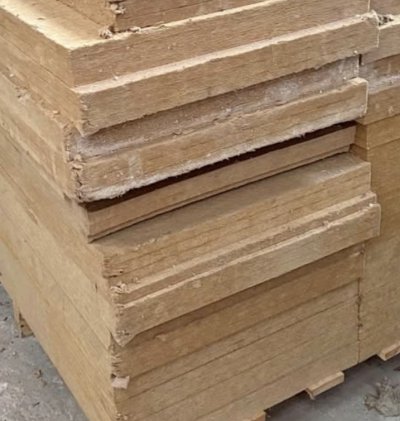

Some brands do…. In practice it doesn’t seem to make much differenceI'm not aware that they have two different sides. Could it be that the second hand ones that you are working with have simply been bleached or darkened by the sun?
Agreed, the last one I did I got half way up the wall before realising I had the slightly softer side facing me. I think the key is making sure you use the mesh to provide the tensile strength.Some brands do…. In practice it doesn’t seem to make much difference

Gonna ask a really stupid question here but which side do you plaster on. Its says light side is sanded, but the light side is fluffy (technical I know). Where as the dark side is more solid and looks sanded![]()
