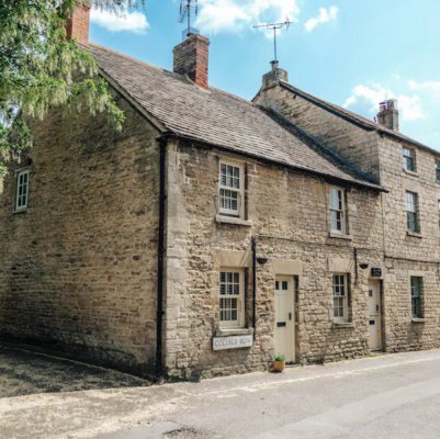

Recently had a damp survey on a property we’re purchasing, specifically went with an independent surveyor that had been recommended and who doesn’t advise DPC injections etc.
The property is 1800s stone and has no front garden, the front wall is straight onto the pavement outside. There is damp in the front walls, some condensation but also patchy cement mortar with gaps.
The report advises that whilst they rarely suggest this, as the ground level can’t be lowered at the front, they’d recommend tanking. My thinking is this is a no go?
Our plan is… repoint with lime, and focus on ventilation initially. See how dry we can get it. It’s also currently vacant so hoping that moving in, opening windows and heating will help a lot.
I’m assuming the council (?) wouldn’t allow us to dig a trench or lower the ground level on the pavement. What else could we consider?
