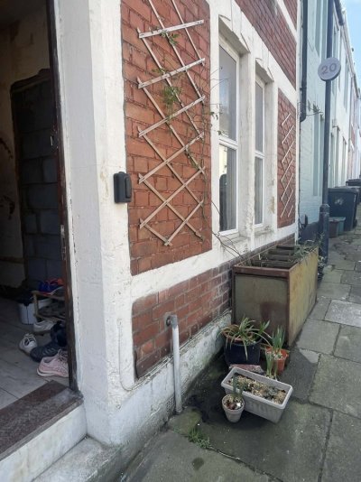

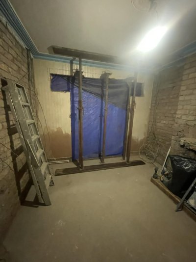

hello,

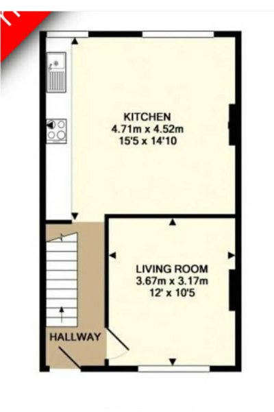

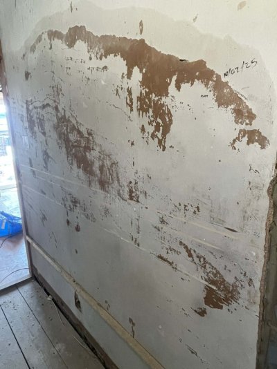

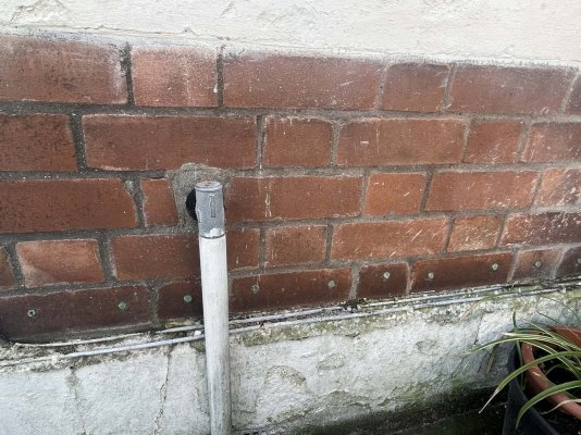

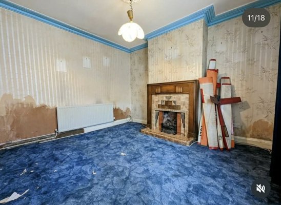

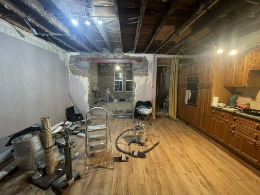

I'm currently in the process of renovating a victorian terraced house in bristol, and our biggest issue so far is 'rising' damp in the living room. we recently had a doorway cut between the living room and kitchen, which has allowed us to uncover a cross section of the concrete floor in the living room (the house is built on a hill, so the living room is one step higher than the kitchen).

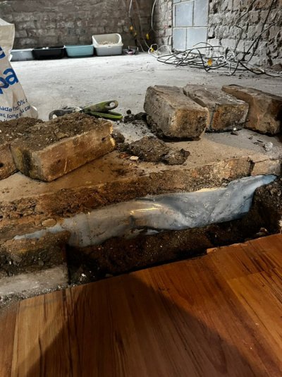

When viewing from the kitchen, we can now see that there is a damp proof membrane in the floor, but it appears to be tucked back into itself rather than attached to the wall. In the bricks we have removed in the knocked through doorway, we have not yet found the damp proof course (we haven't removed bricks from below the kitchen floor level, so the concrete dpm must be above the dpc in the walls.
any ideas what our next step should be? we're hoping to remove a channel of the concrete floor around the walls rather than the whole floor, but i'm not sure what to then do with that channel (limecrete?)
please and thank you to anyone with any advice
