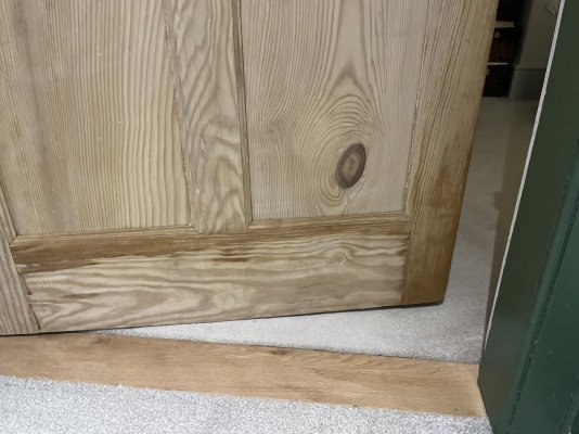

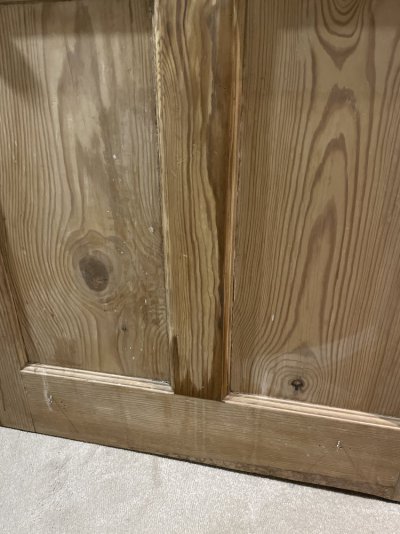

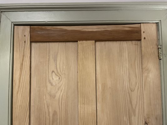

B Bannotti Member Messages 2 Location Cumbria Oct 27, 2022 #1 I had some internal doors dipped 3ywars ago, and they’re still wet! Any ideas on how to dry? I have heating and wood burning stove, but still! Photos attached. Notice the dark parts. 3 doors, 3 damp! Attachments image.jpg 198.2 KB · Views: 7 image.jpg 142.7 KB · Views: 7 image.jpg 220.1 KB · Views: 7

Cubist Member Messages 3,666 Location Shropshire/Herefordshire Border Oct 28, 2022 #2 What makes you think they are wet? Could just be stains in the wood.
RBailey Member Messages 404 Location Rutland Oct 28, 2022 #3 Could it be oil contamination that is making it look wet? I'd try giving it a wipe with some acetone or something to see what happens.
Feltwell Member Messages 6,370 Location Shropshire, England Oct 28, 2022 #4 I'd also suggest they're just stained or oil contaminated. If there's no source for the water, no way would they stay wet that long. Wood is one of the few areas where a pin-type moisture meter can be used with reasonable results, if you want to be sure. Fairly cheap on Amazon
