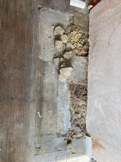

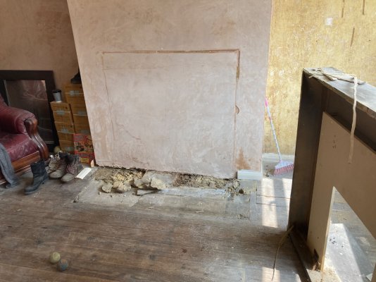

There’s some damp appearing on the side of this fireplace, now having removed the electric fire and surround, I can see the floor is crumbling and is damp
Please correct me if I’m wrong with the following plan,
Dig it all out, check and replace joists as needed
Do I need to create a vent in the closed fire place?
Thanks
