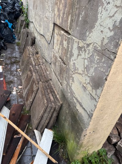

Wall construction is solid brick with a slate DPC which I have attached a photo of here

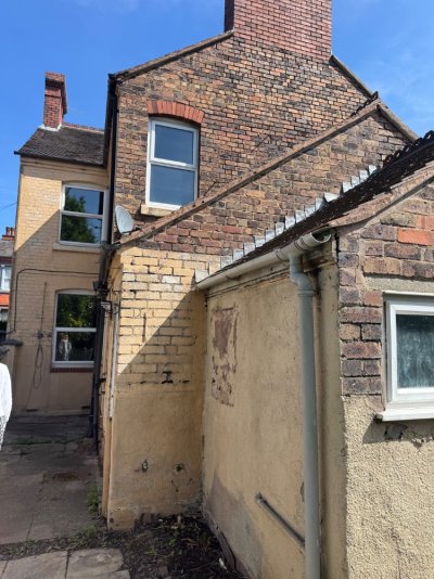

Unfortunately at some point in time the gable end wall has been rendered with sand and cement and a plinth render has been applied around the perimeter excluding the front of the house. I’ve attached a photo of the gable end wall of my property here

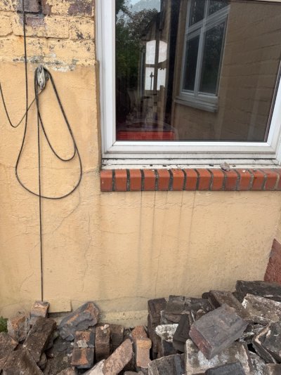

You can see the plinth render here (ignore all of the stuff - skip coming tomorrow)

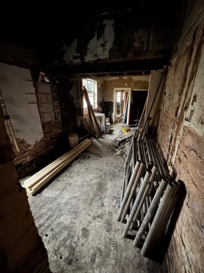

The inside wall of the gable end has also had the old horsehair plaster removed and has been done in sand and cement minus around 200mm at the bottom which was gypsum (fallen off , wall is wet behind it) photo here
I have chipped off some of the cement render and the wall is actually dry behind it, only wet where the gypsum was.

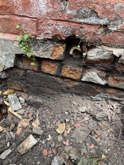

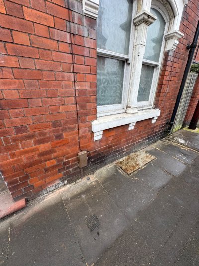

the ground level at the front of the house has unfortunately bridged the dpc. Not sure if there is much I can do about this - photo here
The metal plate is to the basement, and has holes for airflow

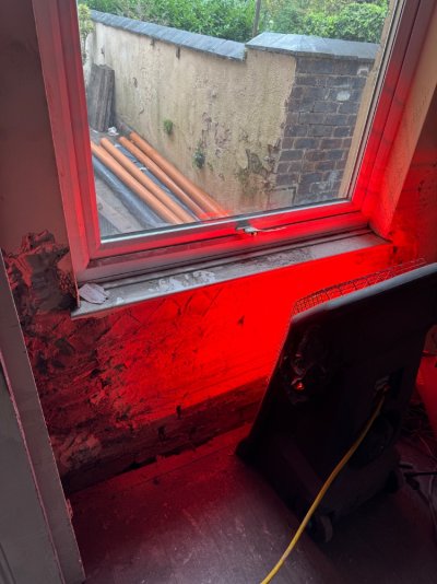

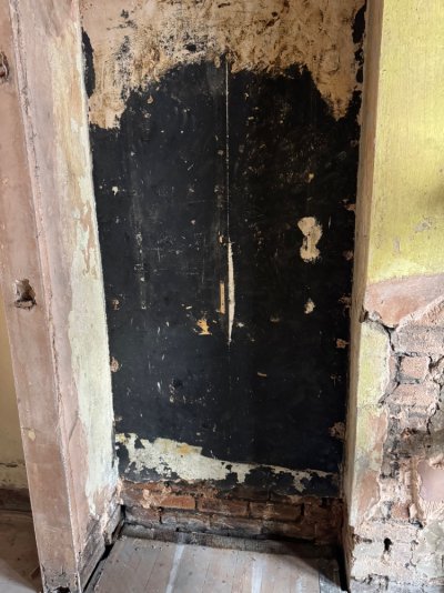

Here is a patch in the middle room that has fallen off, crumbly wet gypsum, wet bricks
And the other side of that wall here
