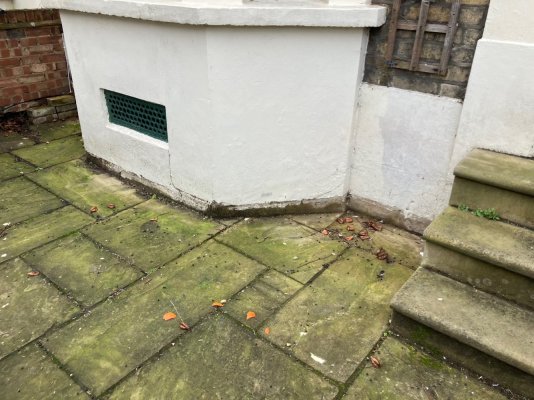

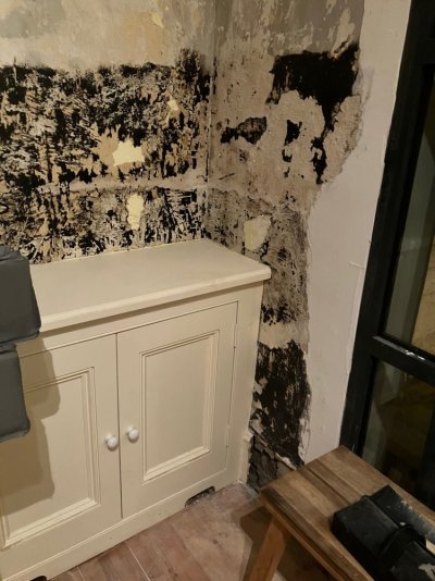

These photos show the two worst damp patches inside with the bitumen paint. The horizontal lines mark the place where the sand and cement has been used below. The front bay rendering is in decent condition apart from the area at the bottom where it appears to have been repaired in places. The weird discolored area next to the steps could be bitumen paint under the white paint. We can clearly see it next to the front door so we know it was painted on some areas outside.
