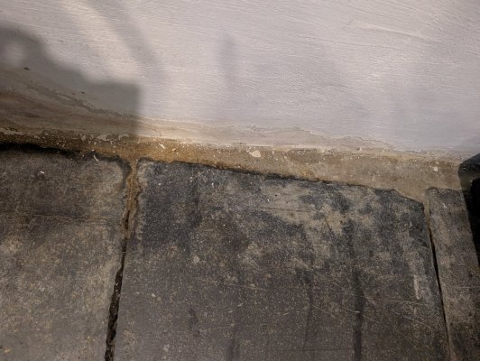

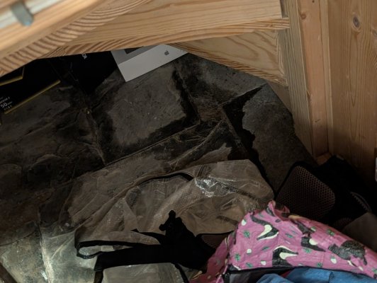

Water coming up between stones under the stairs on the east side of the building - we've had salts appear on the exterior wall before, but they disappeared. First time this has happened.

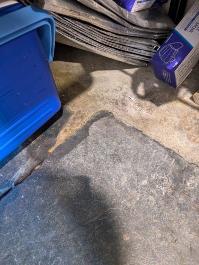

corner of our utility room; this is roughly where, I assume, our mains water comes into the building. moisture up around the end of the stones.

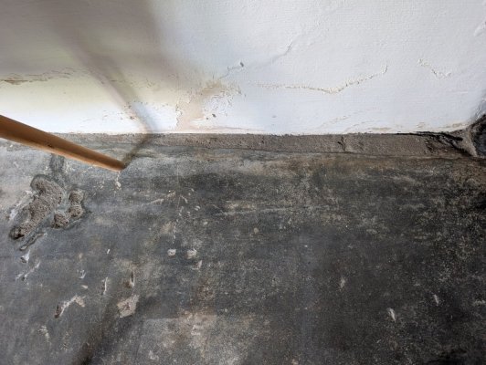

opposite side of the same room. This is an interior wall, not connected to any exterior wall. Our mains water must come under this wall somewhere, in order to get to our kitchen. Apparent moisture between the flags and capillary action in the wall. Someone has put a damp proofing at the bottom of this wall before our time here. Also timber door frames here are saturated.
The other side of the same wall - you can see the DPC in the far corner. The pointing on the floor here is wet to the touch.
